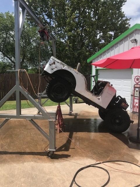

Then I backed the jeep out and pulled this number and pressure washed it in every nook n cranny that I could blast and here I've been putting my hands under the dash~ eeek

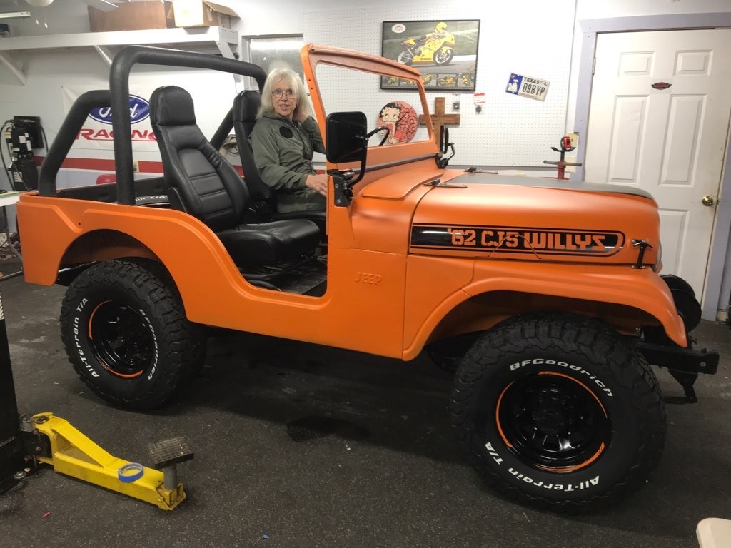

This jeep is my brothers '62, about a 2 year ago project
As said, my brothers finished '62 with an F-134 4 cylinder.

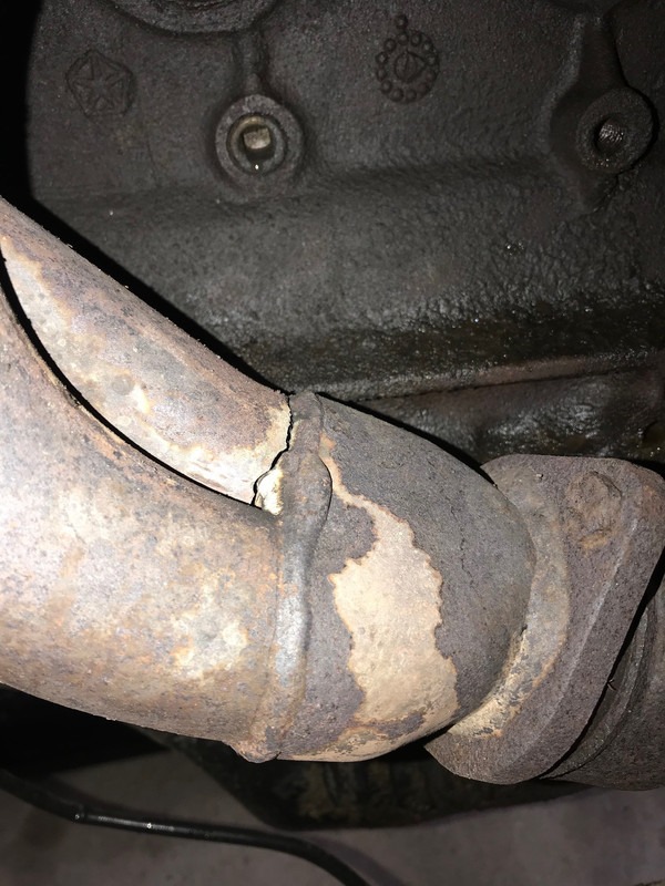

So, pulled it back in and now I knew I heard an exhaust leak! What's a good exhaust manifold to replace this one?

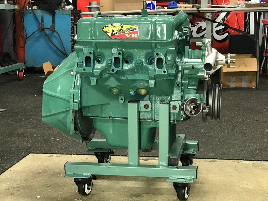

Hi, I didn't think anyone was looking at my build;) I'm thinking that you're talking about the V6 in my '68 jeep? I haven't even started that engine yet! lol I visited a local muffler shop just today and thinking perhaps pulling it there tomorrow. In answer to your question, I've never had a problem in the past with paint in the exhaust mating surfaces, but on the intake I do remove paint residue before installing the intake.

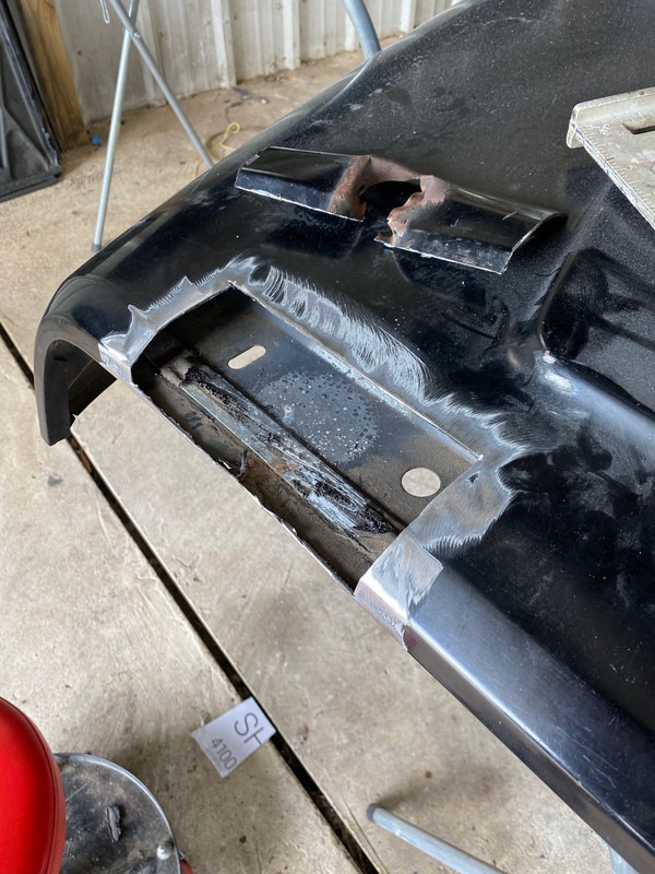

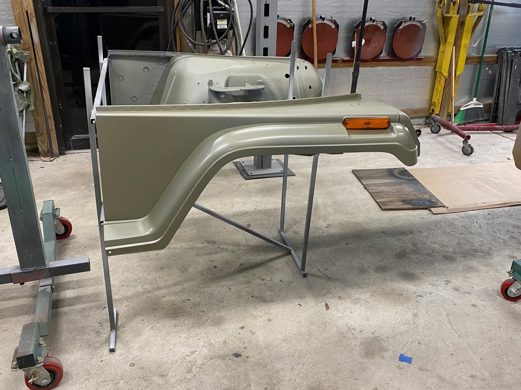

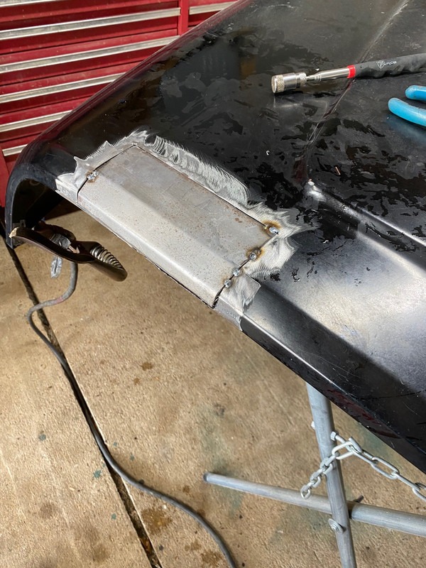

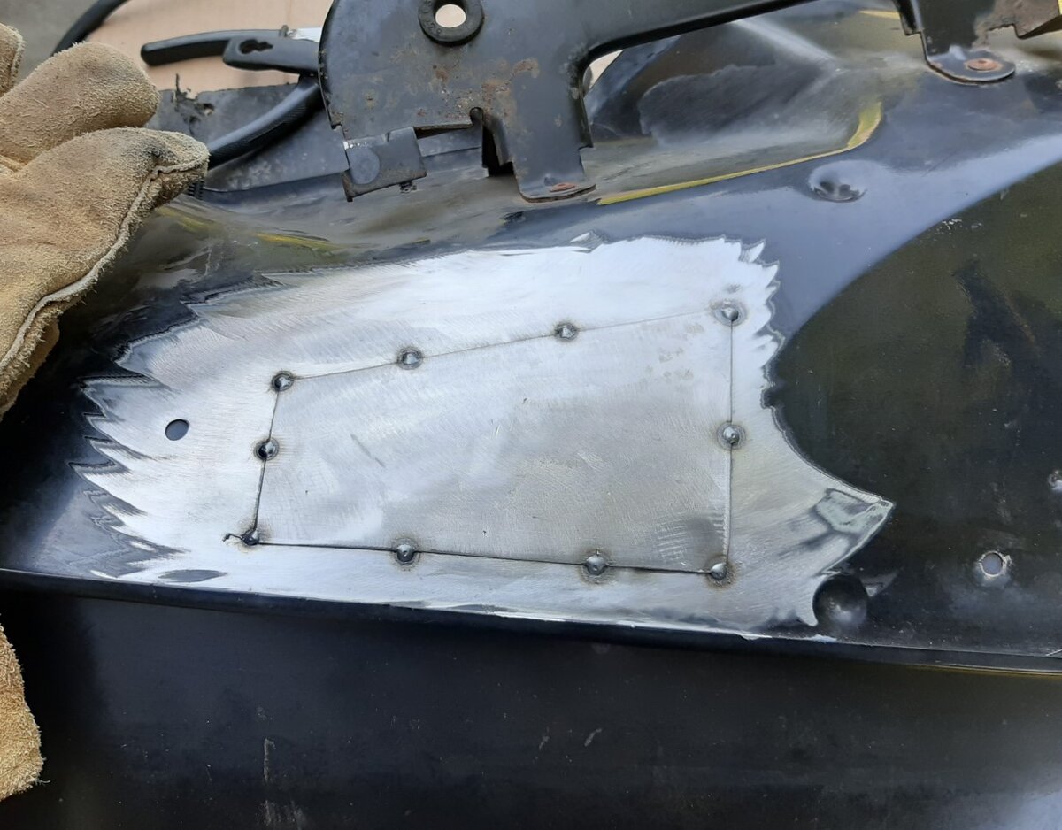

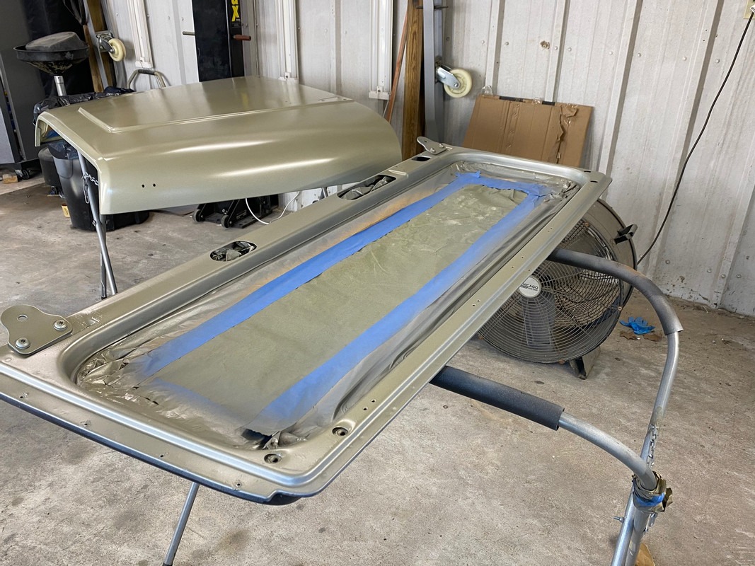

The hood was messed up and rather than buy a hood, I decided to repair this.

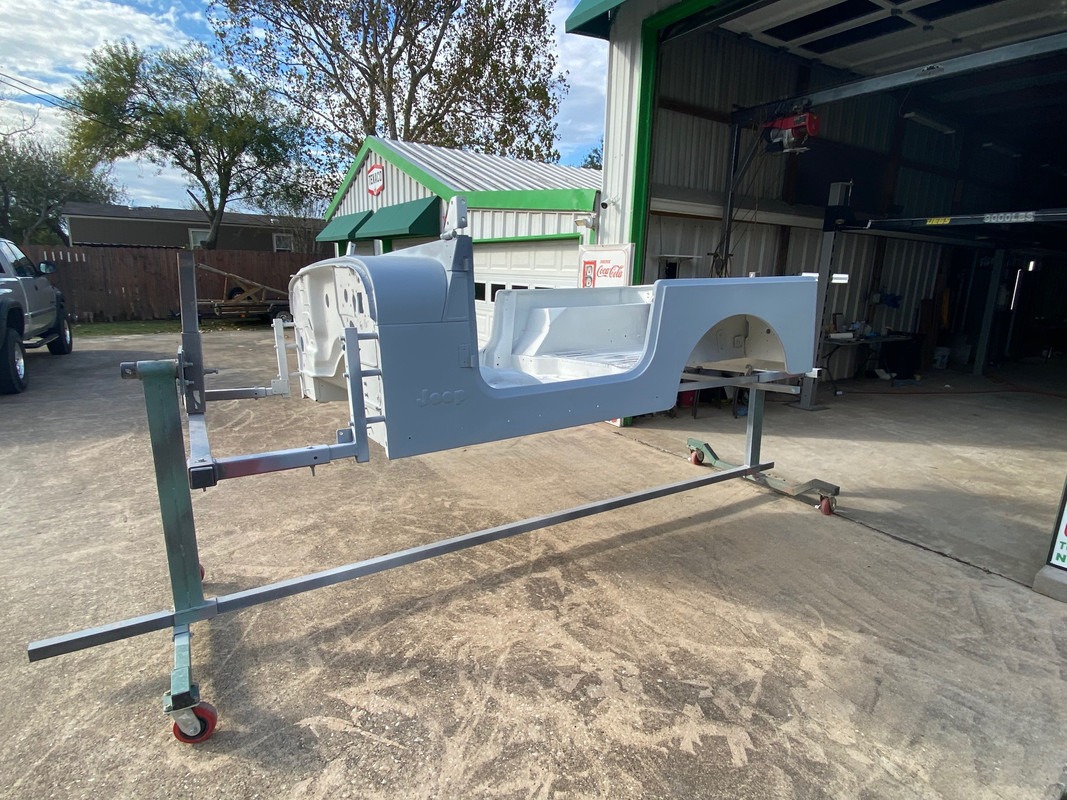

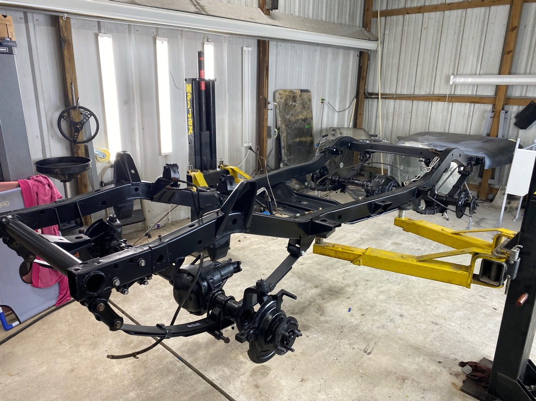

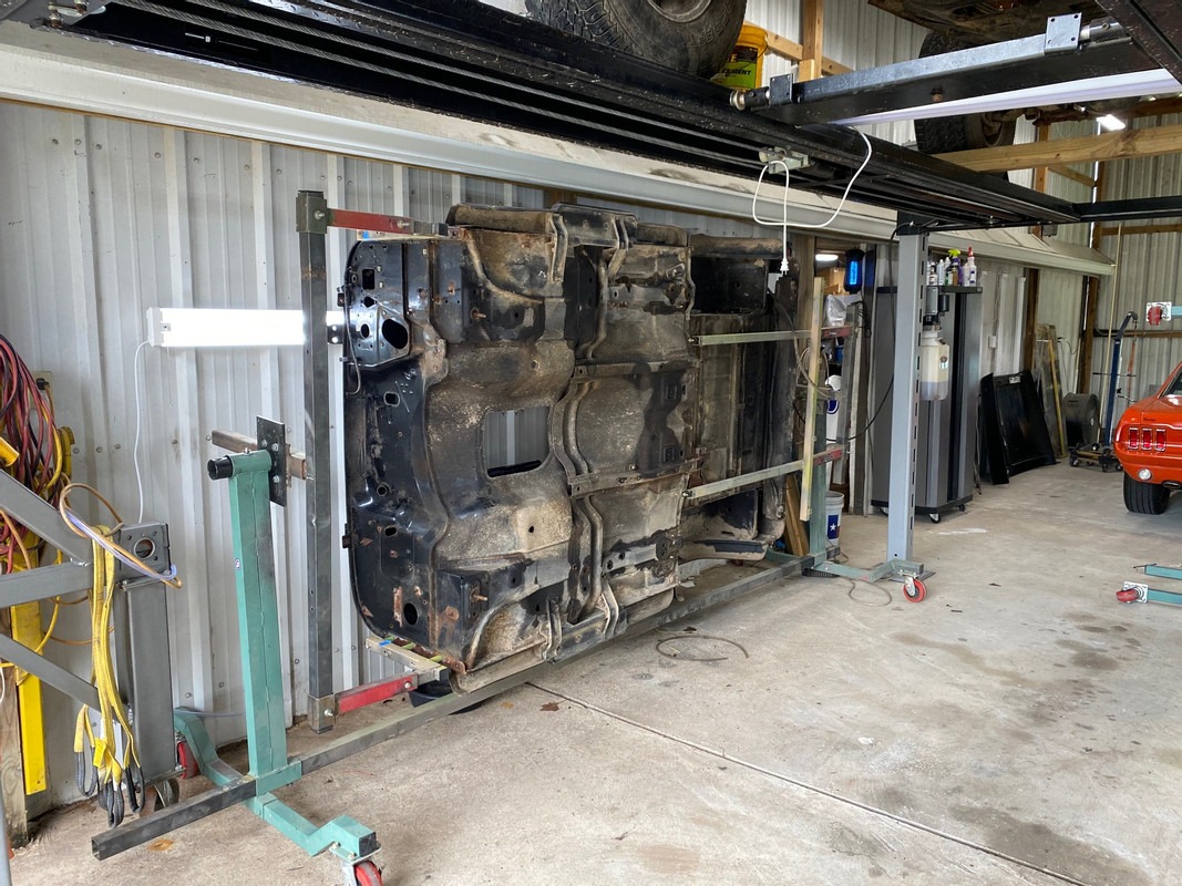

The frame, tub, grill, front fenders, front driveshaft were blasted. The blasting launches really helps me progress like it did on my '68;0

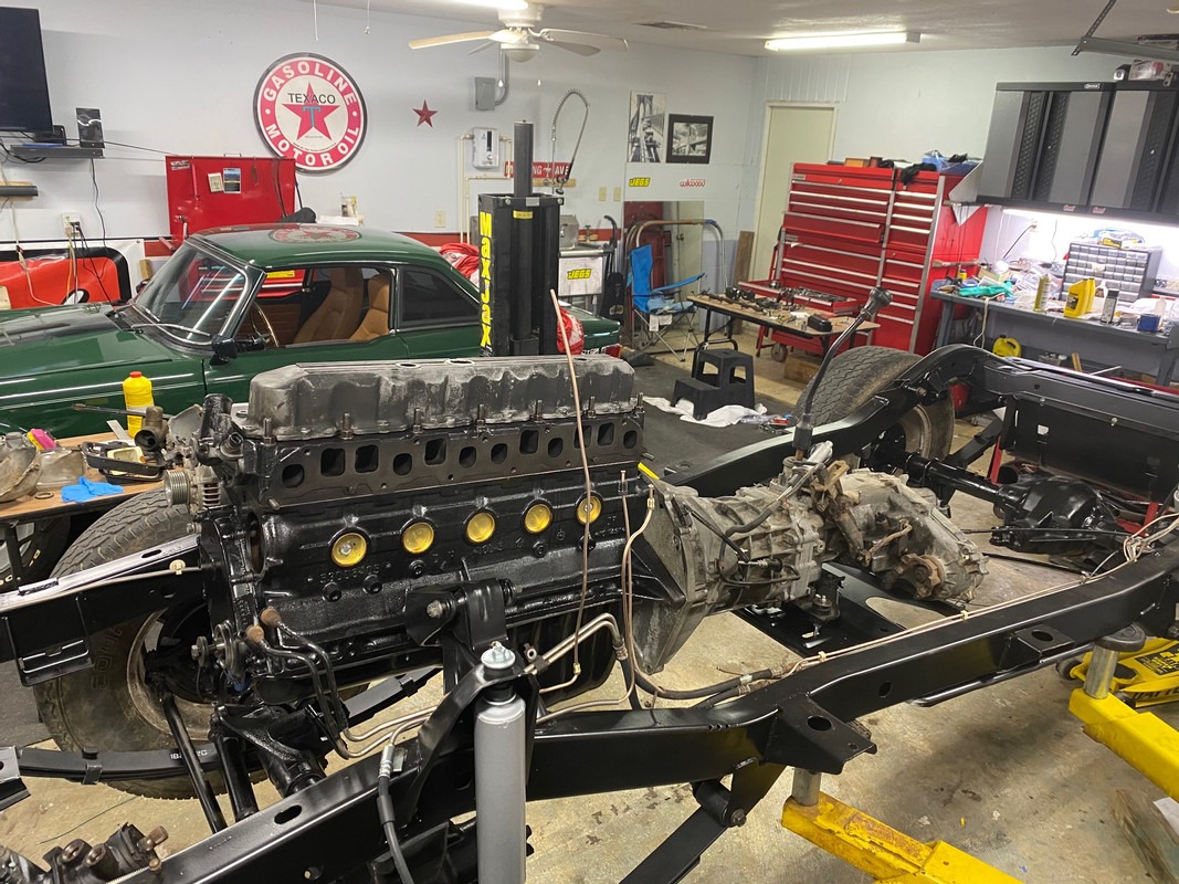

I had the engine overhauled by a reputable engine building place, got it back in record time. I'm not trying to break any records, but I'm getting pretty good at this restoration of jeeps thing;) Still waiting on a lot of parts~ I get them, install them. The valve cover isn't installed yet as I plan to paint it either Krinkle red or high gloss red~ I'd like the engine compartment to pop!

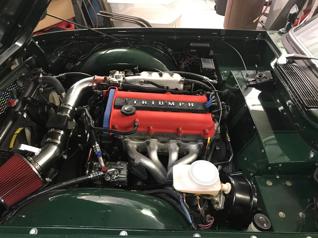

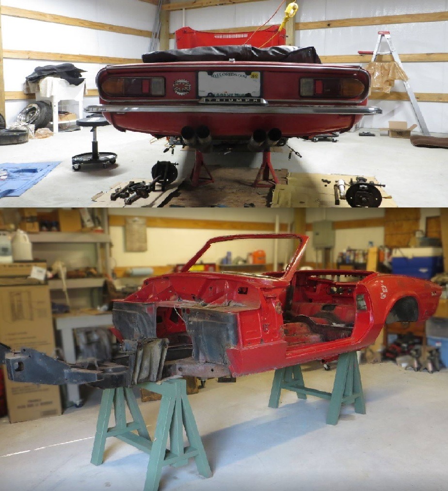

What's the little car hiding in the background? Funny how they find their way into small spaces. My other project is a '72 Triumph Spitfire.

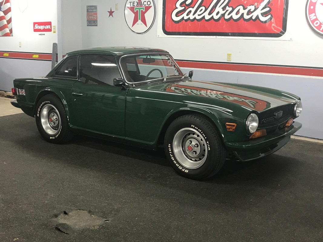

Sorry, went to be earlier than usual last night~ Spitfires are a cute little car~ mine is a '73 Triumph TR6, but I transplanted a '99 Miata engine/trans with a Nissan differential. Basically a Miata with a TR6 body! ;) What are your plans for your Wrangler? ;)

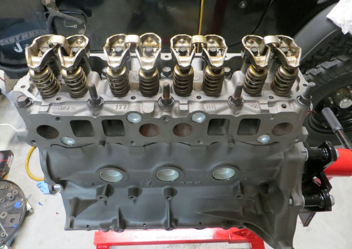

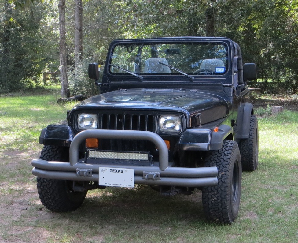

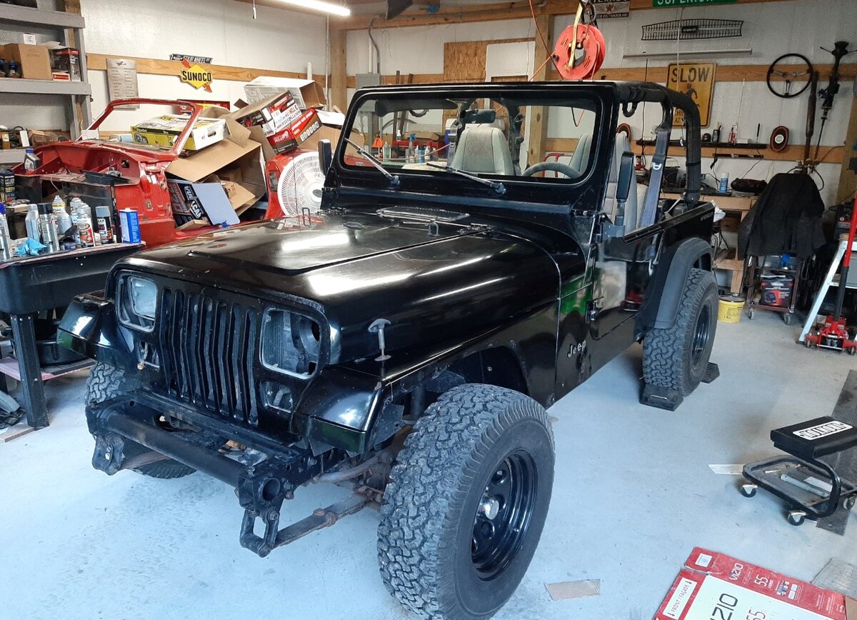

I bought my 92 Jeep YJ in very good condition for a cheap price because the previous owner (first car) ran it out of oil when the engine oil pressure sending unit failed and dumped out all the oil. It's all stock with a 2.5L and AX-5 except he put on 31" tires.
My plan was to rebuild it and sell it but now that it's almost done I've caught the bug and want to keep it. I've put over 400 miles on it since the rebuild and so far everything's running great. I had all the engine machine work done up in Conroe by Ted's and I did all the labor pulling it apart and then back together.
The frame need repair under the skid pan around the nutcerts and then a few rust holes on the body and drivers side floor pan were cut out and patched/replaced.
The next big project will be to spray on Lizard Skin on the inside floor for heat and protection.

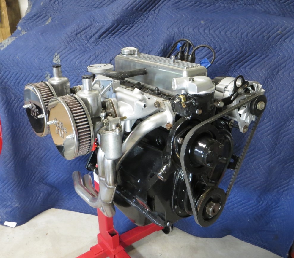

Body work and paint is next for the Spit. I got sidetracked by the Jeep. :)
I Love the picture of your little spitfire engine! and the Spitfire on the saw horses looks like a 1/16 scale model! ;) Jeep looks great!!

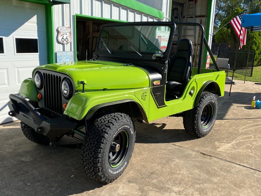

I've been moving at a snail pace, but I'm almost through with my '68 CJ5, just need an inspection sticker/safety inspection then I can be street legal! ;)

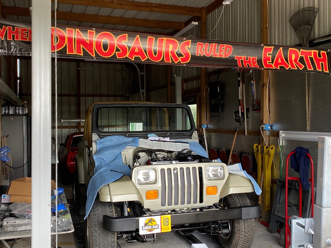

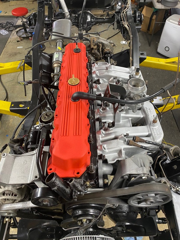

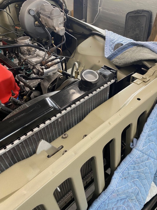

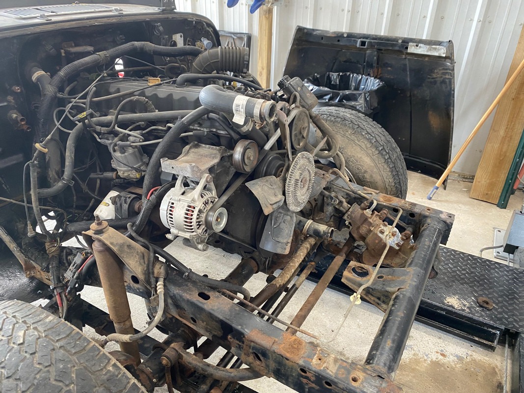

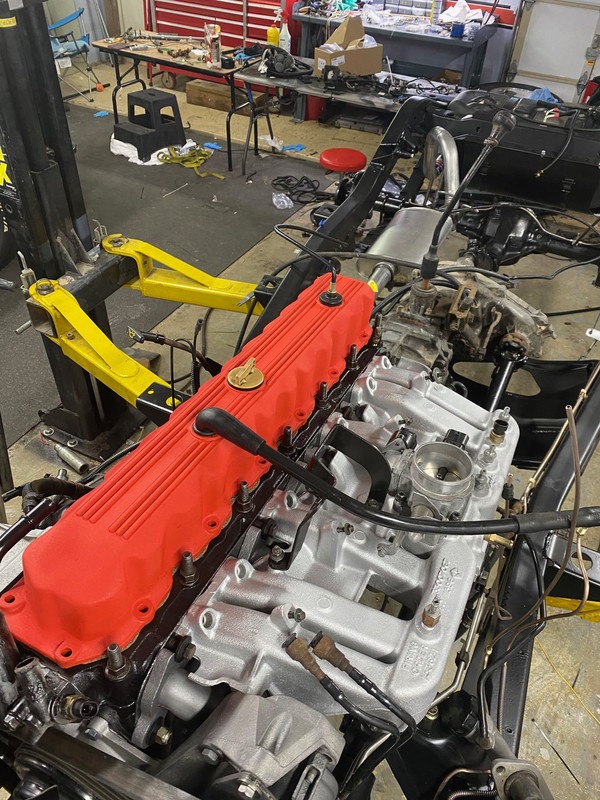

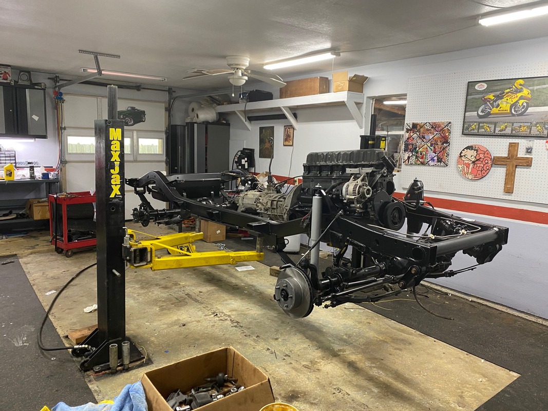

The Jurassic build; the engine is pretty much together, primed, engine wiring harness/injectors installed(not shown). Today I started on the tub for body work, however holidays are here and that's going to be put on the back burner until next week. But it should go pretty quickly, then I can put the tub back on the frame;) Still debating on Air conditioning, just hard to let go of another 1000bucks:(
Also next week I need to go to a local jeep place to buy a tailgate/hinges and other odds n ends.

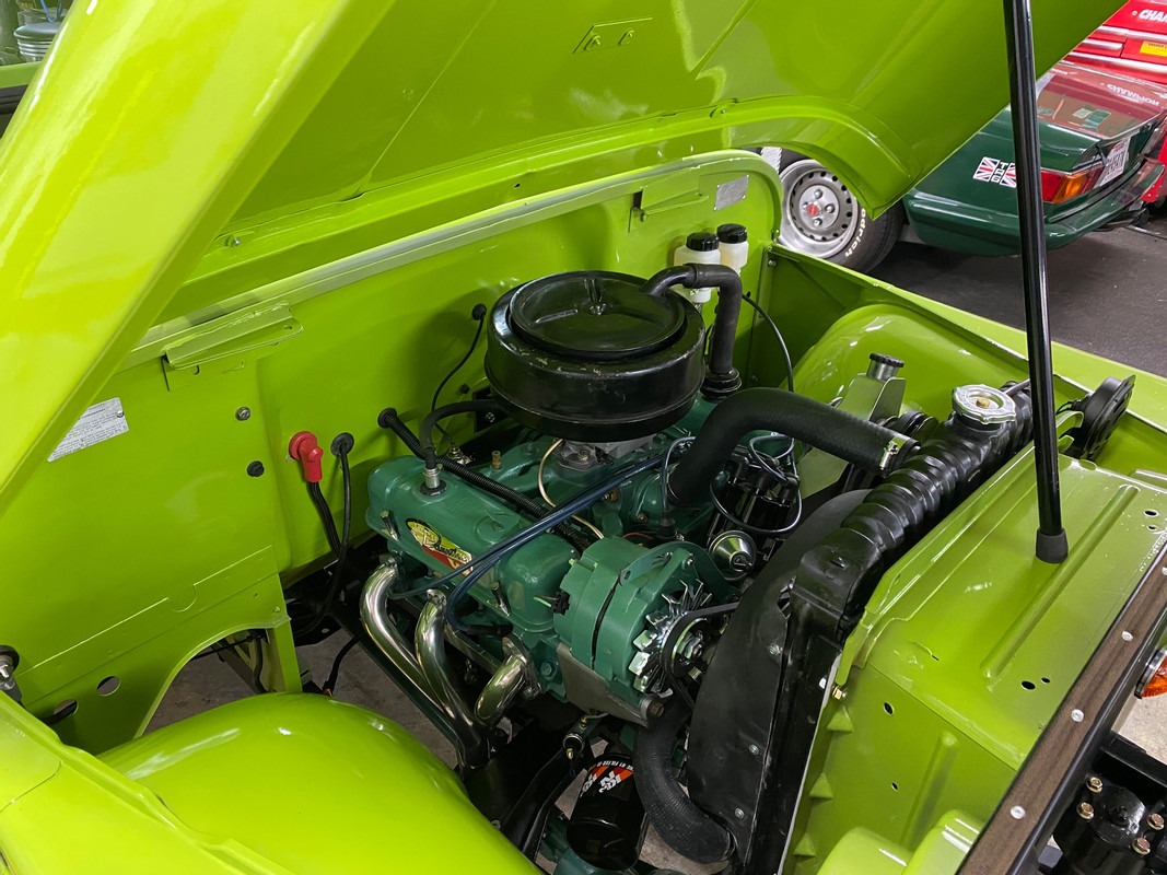

Yes, it's an old fan belt, but as said, undecided on AC. I wish someone made new fuel lines, guess I'll just have to take a dremmel to the lines and see if I can pretty them up a bit. The valve cover is Krinkle paint.
The V6 is very powerful and puts my brothers F134(4 cylinder jeep) to shame! I love it! Still have a bikini top to make, back seat to install etc
My brother had installed some side steps on his new dodge truck, he was sent a new set of steps and I got his old/new ones and shortned them to fit my jeep and they're nice!

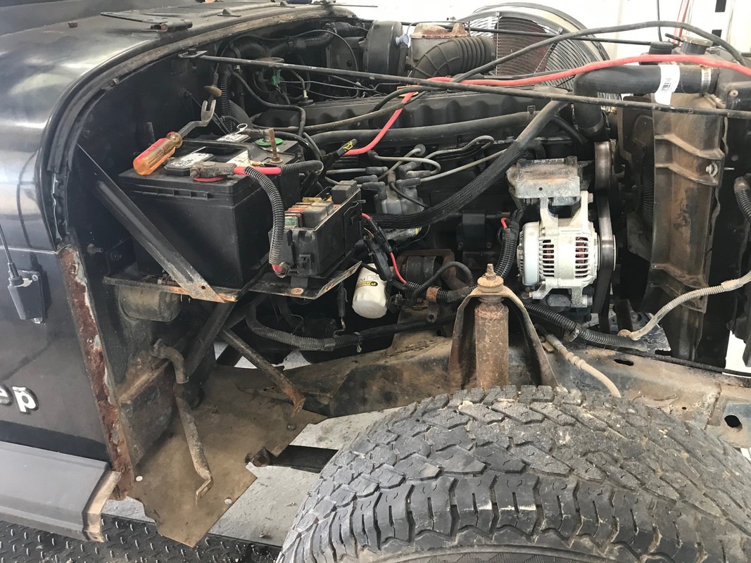

I have yet to refurbish the air cleaner~ always something to do! ;) The battery is located under the dash behind the glove box with a kill switch. I wanted a clean engine compartment;)

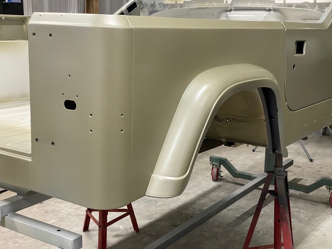

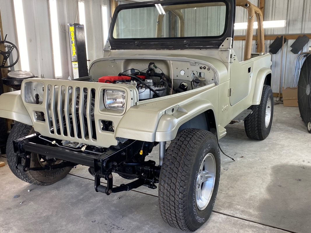

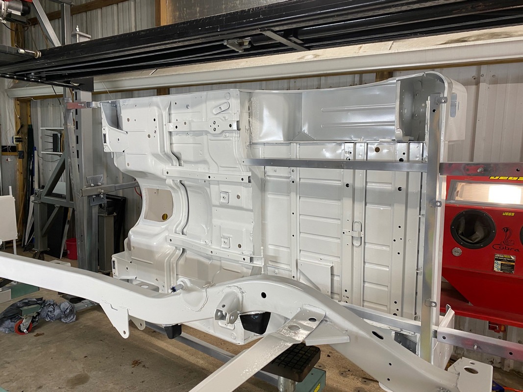

Ok, I've made some decent progress over the past couple months;)

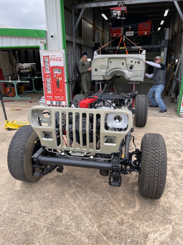

Just happen that my brother came by on the day I was putting the tub on, nice to have him here;)

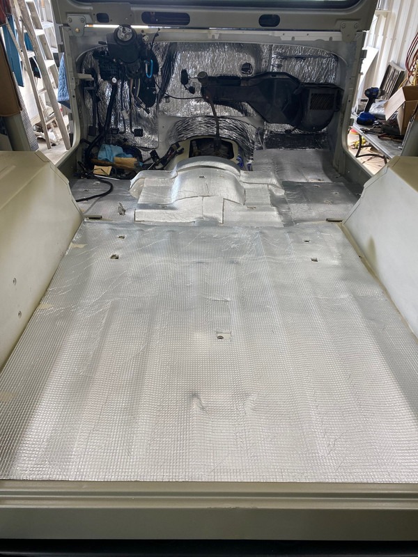

I want my jeep to be quiet, and insulated;)
It's just a matter of putting it back together, still much to do, but kind of relaxed now as most the hard work is over;)
dne'

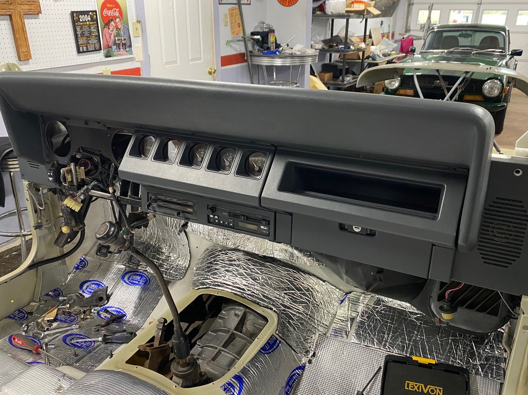

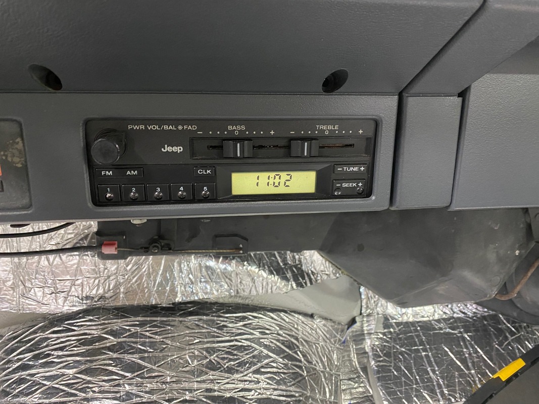

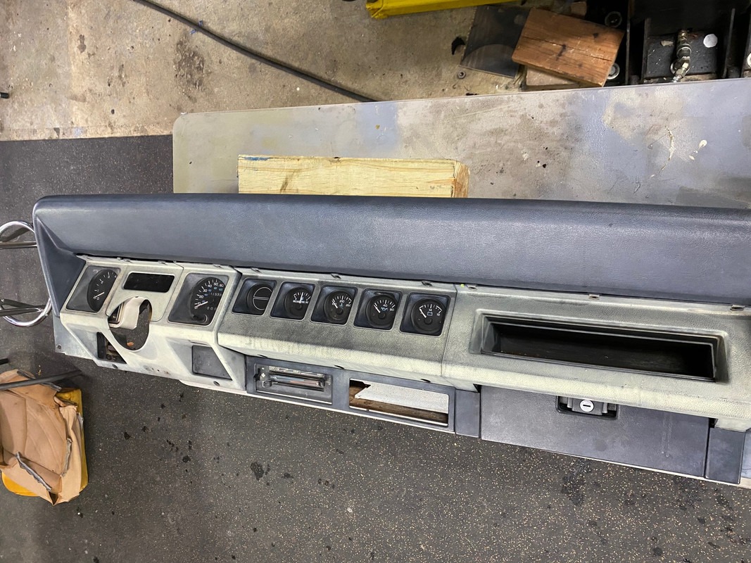

The dash was pretty depressing, old looking, lens's all scratched up, radio didn't work.
When getting to the refurbishing the dash, washed it thoroughly, the sprayed a couple coats of SEM Graphite paint which matched the original color perfectly. Installed new instrument len's, a Newer radio which works, new speakers

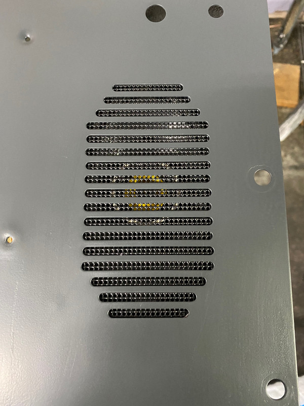

Found some neat speaker "screen on amazon"
THese speakers fit almost perfectly, just needed to trim a couple holes
