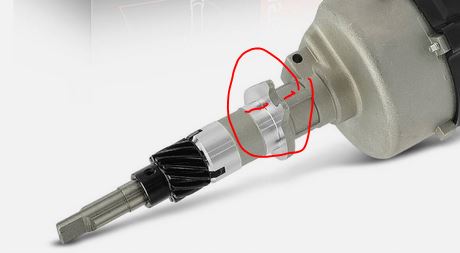

on our 90 4L the distrib. base locking clamp has a notch. that sets the timing correctly, unlike mine.
the CMP in the base of distributor is a sync pulse stator. (jeep named)
the FSM free factor service manual in the sticky post cover timing the distributor, unique to this engine it is.

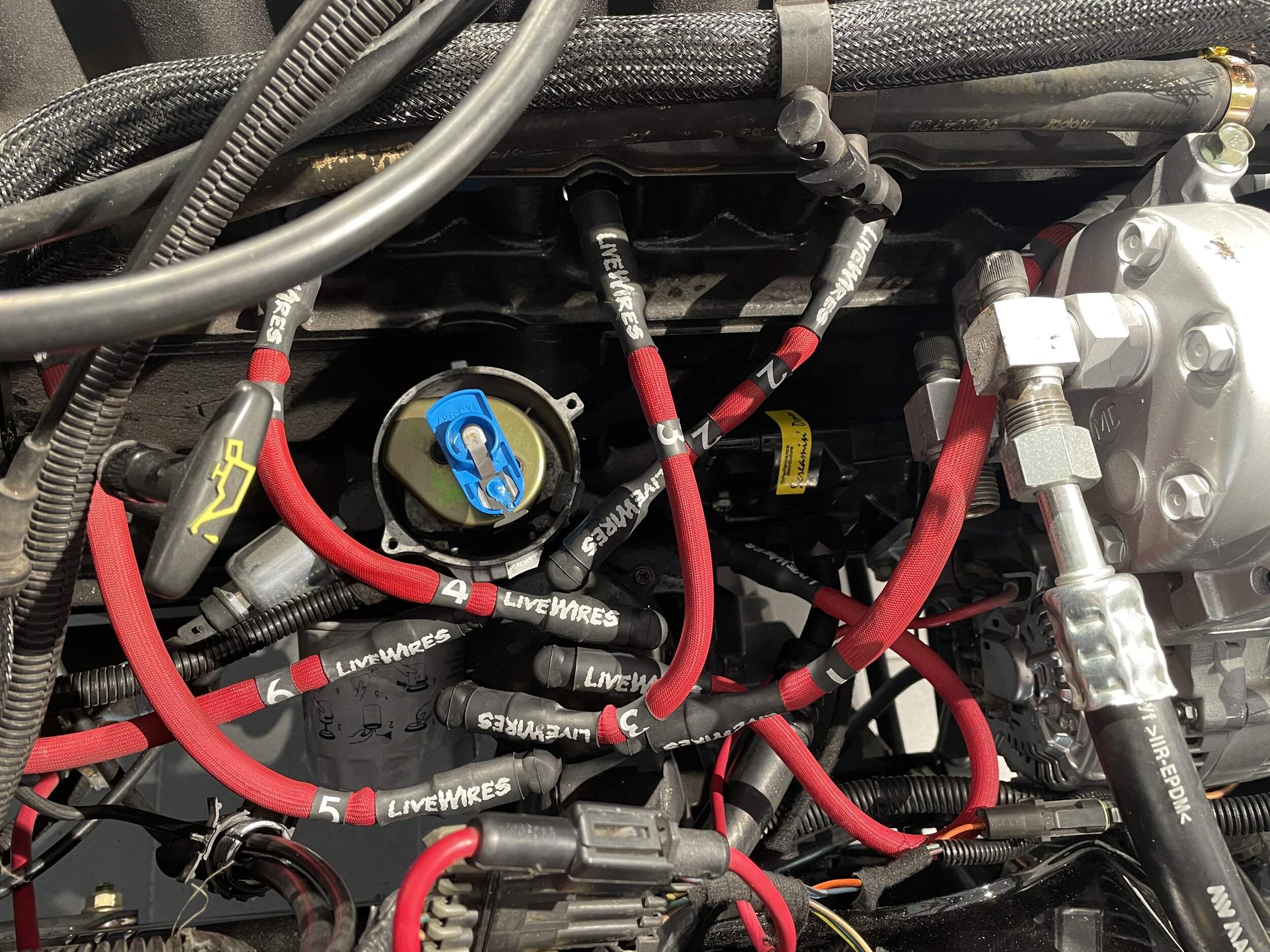

Ok. solved.
What happened: I set the distributor so the rotor pointed at 4 o'clock for power TDC, like the fsm sdvised. The engine did not even fired once. So i decided to try to readjust distributor by one tooth each way. Second try she fired and worked beautifully. The rotor is at 5 o,clock rather than 4 - see the picture.
Thanks for the advices.
