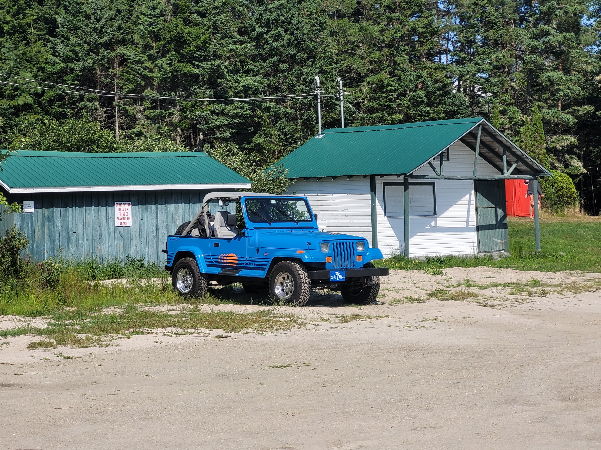

Good afternoon all.
I am looking for some opinions from folks who have experience with both the 4.2 and 4.0 or a good idea anyway.
I presently have a 89 Jeep YJ with the 4.2. 98k on it. The carb is long gone - I have the Mopar MPFI kit installed (basically all the fuel injection/intake/computer/distributor/ignition) from a 94 YJ 4.0L).
I find this engine has great low end power but above 60mph is very flat and you need to ring the guts out of it to maintain 70 going up a hill on the highway dropping into 4th (lots of hills where I live). Most of my driving is less than 60mph (100kph) however I avoid highways because of how hard I feel it needs to work. I'd like to be able to do some longer distance touring at highway speeds if needed in the future.
Back story of how I use my Jeep - no real off road (sorry die hard Jeep guys) - mainly use it for cruising back and forth to the beach (I mean it is a Pacific Blue Islander - kind of the idea!), summer cruises, towing a Sea-Doo, errands, back and forth to work. It is like a practical convertible.
No lift - tires are only slightly larger than original (235-70-15), stock gearing, 5spd.
I'm thinking of swapping to a 4.0L from a later YJ. The engine I'm looking at has similar mileage - no known issues. I'm thinking where I already have the Mopar fuel injection kit, the long block will be a straight drop in with no mods needed - maybe exhaust manifold. This seems like it would be much easier than trying to get more top end out of my 4.2L. I should note my 4.2 also should have valve stem seals done at some point (basically the same price as buying the 4.0L long block).
I've read lots of threads comparing the two, but most people are talking about off-road/slow speed and the 4.2 low end torque vs the 4.0L with fuel injection reliability. In my case, I have the FI reliability already with my 4.2, but wondering if the 4.0L would make a big difference in usability for what I use the Jeep for.
So what is a non-modified 4.0L 5spd YJ like on the highway? On paper it looks like it would be light years ahead of the 4.2 based on the much higher HP and similar torque but is that actually the case? Is a 4.0L YJ more highway friendly and maybe even have some passing power? Can it cruise at highway speed without downshifting and wringing it out up hills? Or where I've already converted to MPFI, am I not going to see much difference or negligible?
I wish I could just go drive one, but there are basically none left where I live (Nova Scotia Canada) as they all rusted out years ago. Rare to see a YJ. Rare to even see a TJ now. I had to import my YJ from the southern US.
Also, I'd never sell my YJ and buy a later 4.0L so no one say go buy one. A couple reasons - to much sentimental value to this particular Jeep, condition of it, and also 89 Pacific Blue Islander trim is my ideal jeep and you can't get that in 91 or later. Navajo Turquoise is nice, but for me, Pacific Blue is the ideal Islander color.
I guess the other part to this post - is the 4.0L a quick swap (as I believe) at this point since I've already got the factory 4.0L FI system installed?
Thanks for any feedback folks!
Nick
Surely you'll get plenty of opinions on this one. Nice YJ BTW. One question would be what gears? My last CJ, a Jamboree edition, had 2.73 gears and was a 3 speed auto. Ive had 5 XJ's with the 4.0, 4 CJ's with the 258, 2YJ's with the 4.0 and 2 TJ's with a 4 and 6 and a 4.0 MJ, to compare. Will you get blistering passing abilities with a 4.0? Id say no. 258 with the 4.0 head? others can answer that one. Is it worth the work of a swap which I believe will require motor mounts etc and do you have a BA10 trans which IIRC changed to the AX mid year 89? Curious of a little distributor/ timing curve adjusting would do anything for you??
