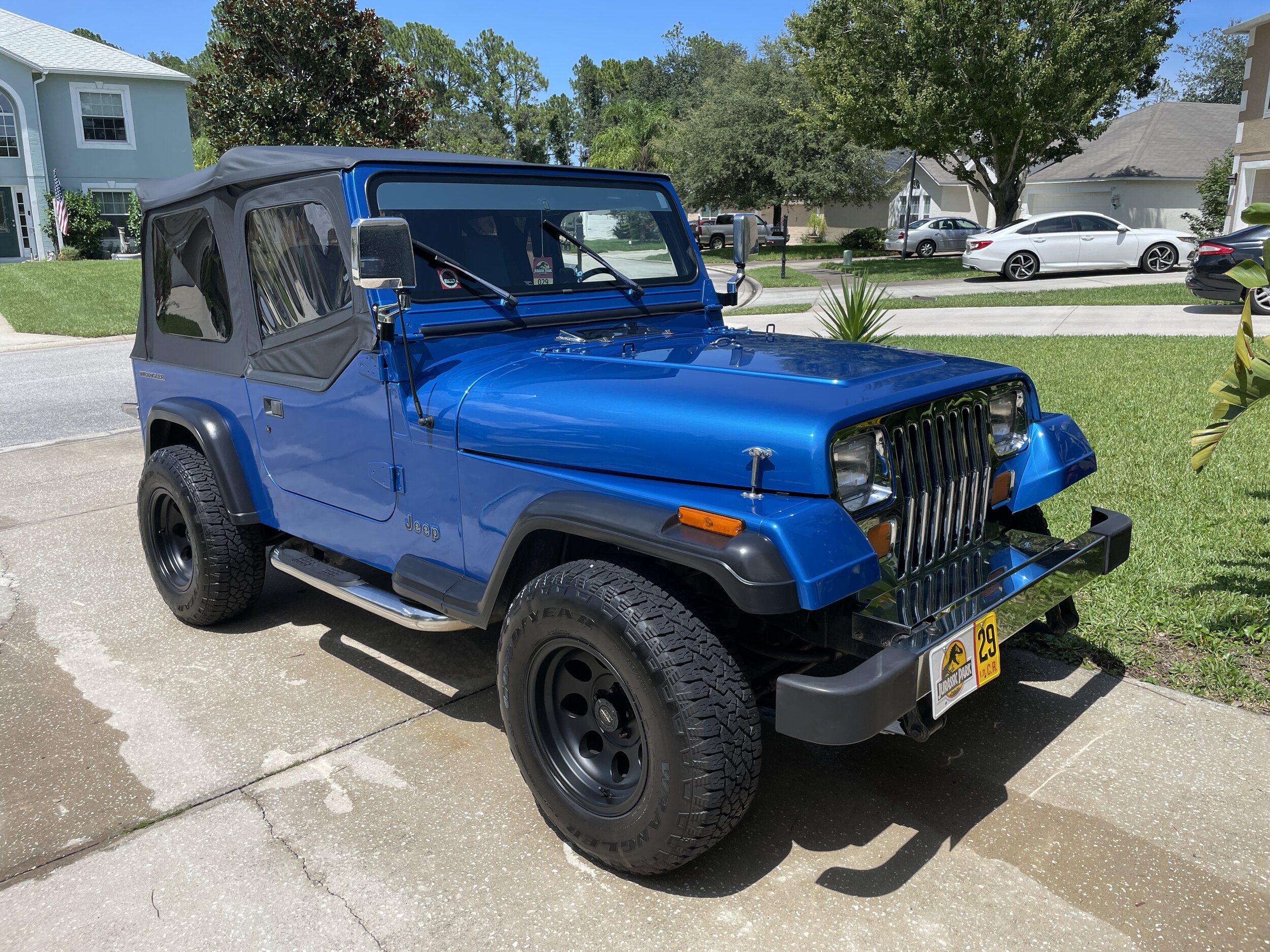

I have a 1993 Jeep YJ with a 2.5L engine and the AX5 five transmission. 188,000 miles. When Jeep has been sitting for a while and I started up, it often takes a very long time to start and when it does start it idles incredibly low sputters a lot and sounds like it’s not fully running. If I give it gas, it will stall. Once left running for about 3 to 5 minutes, The RPM will stay right at 1000 and the jeep runs perfectly fine every time.
