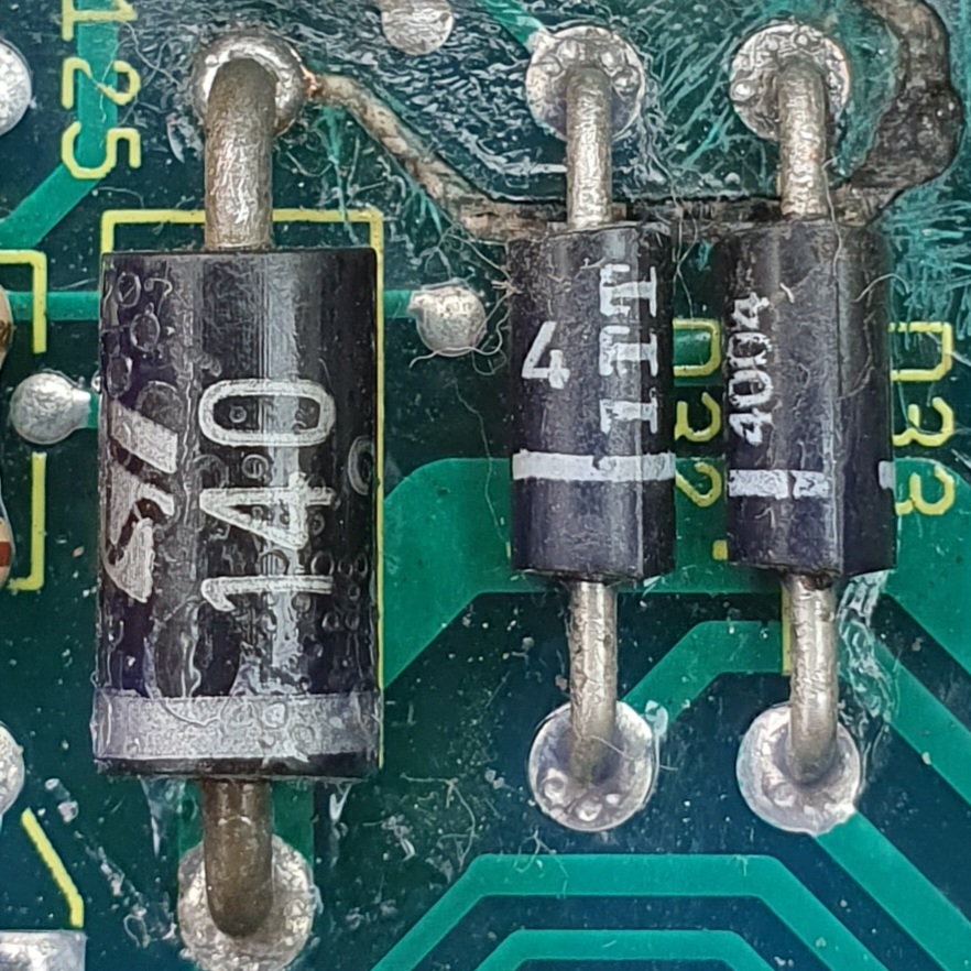

Hi, Im going to try replacing the three infamous capacitors from my original 1989 ECM. Do you know the three capacitors I need to buy please?
Looks like 2 x ITT 4004 and 1 x ST140 written on them?
Thanks all.

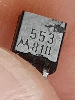

Hi , back on to the ECM repair. I've got diodes on order for the three main culprits above. But I now need to know what replacement I need for the attached transistor.
The markings just show 553 above 818 and a Motorola logo.
Any clue what I should be replacing it with??

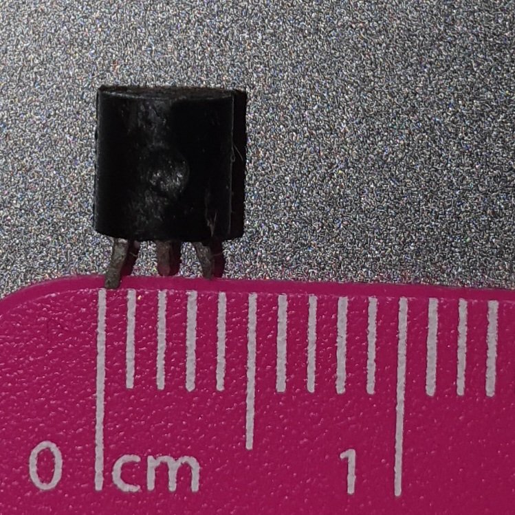

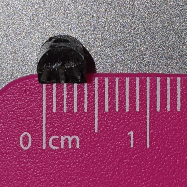

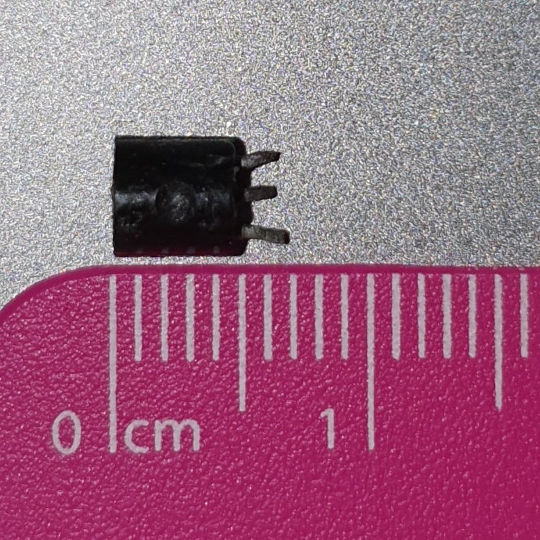

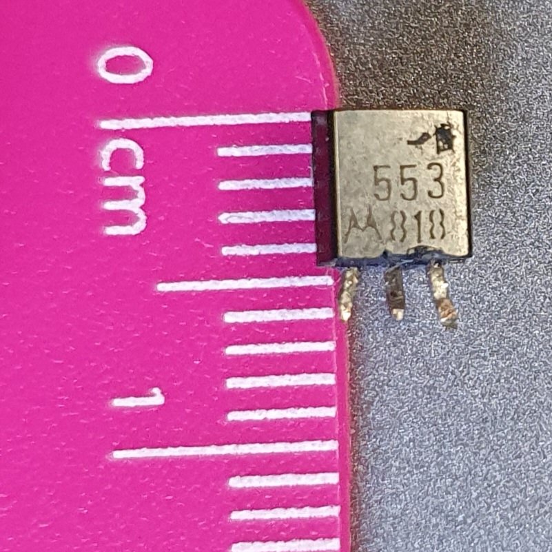

Can you take a couple more pics so we can see and determine the transistor package type? And lay a ruler beside it in one of the pictures for reference.
Hi, here you go. I'm looking on the net but nothing comes up matching the 533 or 818 on any transistor. Someone told me they may well be from 1978!

Ok, by the measurements it is a TO-92 transistor package. That did yield a hit on a search for [t0-92 553 transistor]. Found a possible at Digikey. ZTX553, don’t quote me on this and if it were me, I personally would try to contact Digikey or Mouser electronics and inquire as to the specs of you old Motorola 553-818 and see about the compatibility. I’m not much help I know but working with old electronics these days can be a pain. Also if you have a locale electronics shop that would be a great resource also, if only for info.
